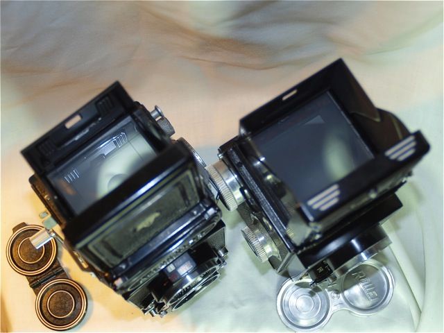

This is the Autocord LMX version. The meter is quite accurate within the limitations of selenium, I suppose. Very well made. All operations are smooth.
The Rollei is nice, however. It's a bit lighter than the Minolta. Probably due to the addition of the meter. Much dimmer viewscreen, though, especially since the Minolta has an added bright screen.
All in all, I'm surprised just how similar in size, weight and feel they are.
