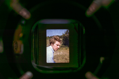

Here's the most simple first approach:
- Remove the projector lens
- Point the camera into the opening
- Snap

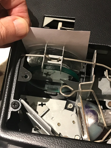

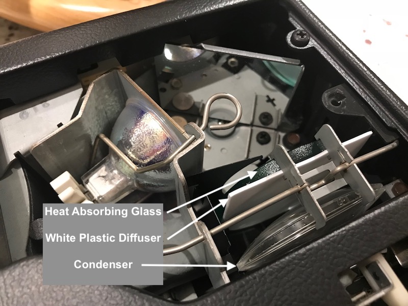

Oops, we need a diffuser for the light. Opening the light box on this 760H projector, I can slip in a sheet of diffusion material between the condensing lens and the slide. There is plenty of room.
[ EDIT: This isn't the best place for the diffuser. See #37 in this thread. ]

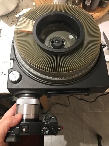

Sony A6000 with the Sony 30mm f/3.5 AF macro lens is the first attempt. Yes, I can capture the slide. And, the color is within reason.

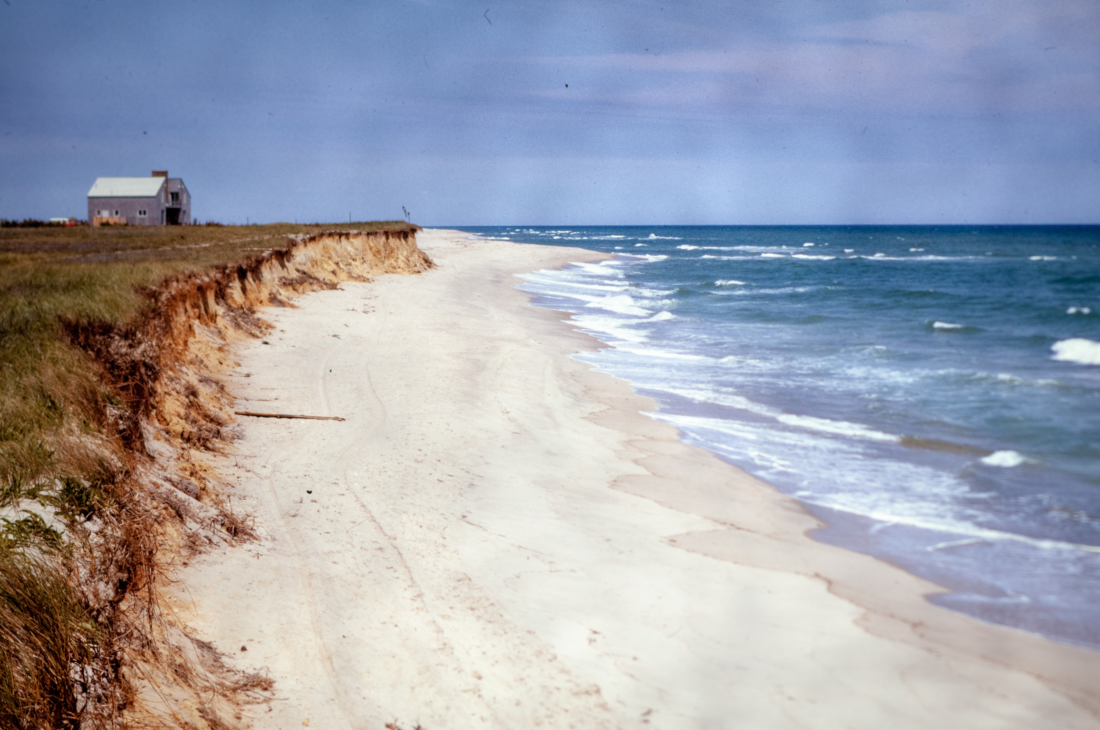

Here's the same shot with a big crop and a bit of adjustment.

Another, both are chromes from 1970.

Conclusions so far:
- Need better diffuser. (The mottled sky in first photo; those aren't clouds)
- Without hacksawing the projector, and with this "normal" focal length macro, I get about 1.5MPx out of my 24MPx camera. I will have to hacksaw the projector to get closer to the slide and probably also use a longer focal length lens.
- WB on these is 3400K; that matches spec 3350K for the ELH bulb in projector. Good.
- But, I want to get rid of the heat and get a bulb with less brightness. The ELH bulb is 300 watts (Yikes!). I want to figure out how to get an LED bulb into the housing.
- The workflow looks great: Slides in carousel or stack loader. Press to advance slide. Click to auto-focus and expose. I can run 100 slides in perhaps 10 minutes. Repeat. Then load the whole set into Lightroom.
- Slides have a lot of contrast. I might just bracket exposures and HDR the good images in Lightroom.
- My Coolscan will probably do a better job with color and tonality; I'll want to rescan the keepers.
- So far, this might be better overall than sorting slides first, then scanning the selects. Should be able to produce satisfactory files for record shots, snap shots, and I have thousands of these.

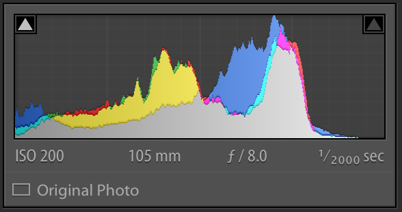

Next step: APS camera (D300 is handy, 12MPx). 105mm Micro-Nikkor. Same arrangement, hand held, shooting into the hole. Nantucket 1970. (Ignore the mottled sky; that's my crummy diffuser.)
I think this is encouraging. With APS and 100mm macro lens, I can fill the digital frame with the slide contents. I won't have to hacksaw the projector. About 10MPx in this image.
So, next steps: 20 watt 12v bulb, better diffuser, solid camera mount, more careful alignment. That'll be in a week or so.

The beach image already seems pretty sharp when looking at the lower left edge!
Might be it’s just the slide being miss-focused.
Did you check it with a magnifying glass?
(I'd say >30% of my family’s slides were not in focus)

How much contrast in slides? Here's the histogram from the beach scene.
There is more density range in the slide than in color negatives. Camera-scan of slides may benefit from bracketing and HDR. Will do more experiments on this.

The projector lens doesn't come into play. It's removed and you stick the camera lens right into the chamber.
Exactly. Longer focal length lens allows slide to fill more of the image area.
For anyone who wants to try it at home: 1) rig some kind of diffuser, be careful it could get hot in there, 2) remove the lens, 3) poke your macro lens into the hole.

Next step.
- Same lamp, 300w, overkill but hard to switch-out. It's 3400K type ELH.
- Better diffuser. Cut from plastic lid for storage bin. Seems color neutral.
- Camera on tripod, aimed more carefully and kept in position. APS camera Nikon D300, 105mm f/2.8 AF Micro-Nikkor. With this lens, I can fill the frame with the slide image.
- Bracket exposure. For some slides this helps.
Here's an example, food prep at a beach party 1970, shade but direct sun in background. This is a Kodachrome slide. 10MPx from this 12MPx camera. I think this is pretty good.

Key is to place a diffuser in the light path. Best place seems to be on the slide-side of the heat absorbing glass (the flat glass, not the convex lens).
Caution: It's a 300w lamp, make sure you are comfortable you won't start a fire. I want to switch to a lower wattage lamp. In the meantime, I plan to limit the run time.
What material for the diffuser? I cut up the white plastic cover of a plastic storage bin. It's about 1mm thick. Passes plenty of diffused light. With the 300w bulb, exposure is 1/1500, f/8, ISO 200. I'll be happy with two or three stops less light and heat.
