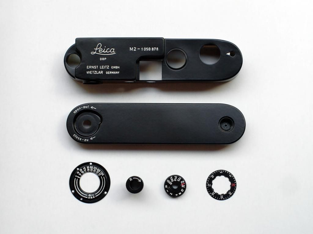

Not converted yet, this is a WIP from my M2 which I've done in my spare time.. I use powder coating/electrolytic paint..
The final coat result get little thick in some engraving, make the text not properly pronounced..

I've done it.. she's just converted
I strip the timer & preview lever, cut the 'vampire tooth', clean the RF, re-skinned with Grip-Tac like material, implant new shutter from salvaged Canon F1.. so far, the shutter speed sounds good to ear.. unfortunately, the RF patch still can't align well on infinity and the vertical adjustment cover screw is MIA
Not perfect, but good enough for me

but did you strip the chrome first?
could you please give us a source for the grip-tac material (I guess we're talking about sheets, right?)

yes, I strip the crome but not the nickel since I don't have the chemical.. powder coating required the part to be sand blasted first, thats partialy remove the nickle but not all.. so it might not brassed good..
for grip-tack like material.. I use 3M safety walk medium type for swimming pool, wich is intended to be comfortable to barefoot..

The biggest pain is prepping the brass after removing the nickel. The parts have what is called 'smut' after chemical nickel removal (yes, that's a technical term) and it's a real PITA to remove. The best way is via bead blasting, which results in a nearly perfect surface for paint adhesion. I have painted in the neighborhood of 100 or so Ms and other cameras. A few were done with lacquer so they would brass, but most were done with a very robust semi matte black which is pretty much guaranteed not to wear off. Which begs the question, why bother removing the nickel when it's a big chemical mess followed by tedious bead blasting, if the camera is never actually going to 'brass?' The paint adheres to the nickel extremely well. The cameras I painted were not designed to closely match the look of original black enamel, so brassing ultimately was deemed irrelevant. There are cameras in the field coming up on 8 years now and they look just as they did when completed. One is listed on ebay as we speak...
Regarding vulcanite, I posted this a few weeks ago, but the closest match to replacement vulcanite that I've ever seen is this. A USA vendor and reasonably priced:
http://www.rangefinderforum.com/foru...87&postcount=9
The M2 I just finished actually had the parts painted about 6 years ago. The parts were stripped to brass on this one. The paint is extremely tough; even the lugs and the end bolts are painted black. It has the hugostudio vulcanite.
