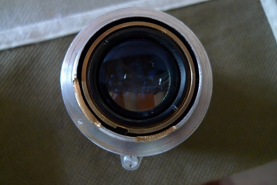

NOTICE: This is a horrendous job and I know it, it might induce heart attack if you love one of these lens. It works though. The SMALLER filed position is the correct one. Don't ask me why I filed away a whole chunk of it before realizing it's the wrong place.

Oh - good - you fixed it. !
Now, your smaller cutout looks like it's the wrong position, based on what Roland posted. Your larger cut out seems to be the correct one. Yet you say its the other way around. Could you clarify, pls?

Uhm I can't remember what Roland's looks like. When I look at it through the back of my M3 the smaller cut is where the rangefinder cam meet the lens helicoid.

none of the photo's are showing up for me, get a 404 error.
For the cut-out position- have you tried putting the lens in the M-Adapter that you plan on using? Set the Nikkor to 0.7m and eyeball the position.

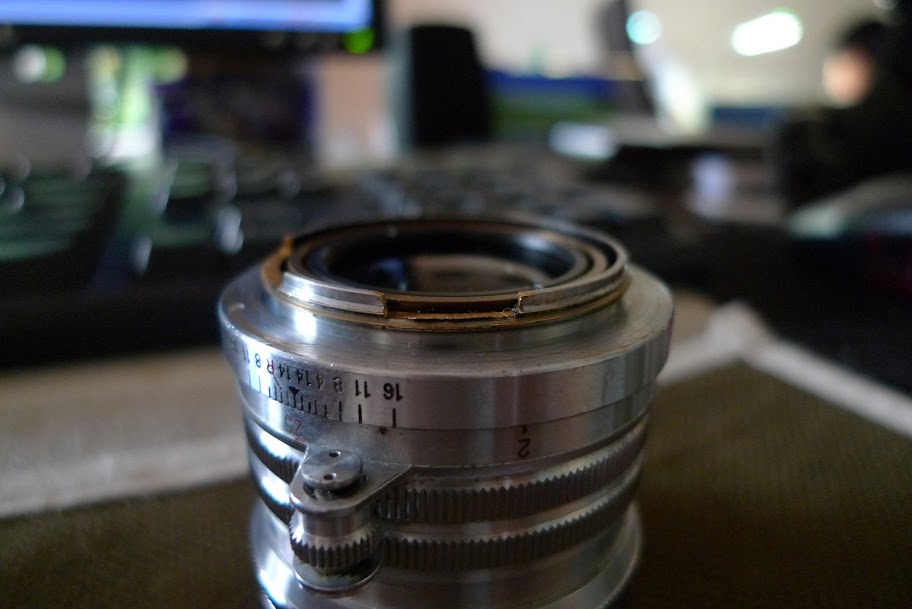

Well, I did it! Took me all of 30 min, and most of it was to cover the helicoid threads. Filing was easy, yet one has to be careful. Works great at the end! I went with a different approach - I made mine look like an M-mount cutout - works like a charm and looks nice I think. My cutout is at the same location as Roland's and your larger one. Well, here are the pics - just freshly done:

Lovely work! Have fun with it. I might need to check mine though because while it obviously move the focus patch until 0.7m at the wrong position the lens seems to front focus.

That looks really good. We'll have to start a thread with "closer than 0.9m in LTM".
BTW: Add one point for the FSU cameras with "fingers" instead of rollers. My Zorki 3M can follow the modified J-3 and my LTM Nikkor 5cm f2 in much closer than the Roller based cameras. No filing required. The narrow RF follower makes it possible. "My Opinion" is that the FSU designers intended that as a feature. Some of the J-8's focus closer than what a roller-based pick up can do.

You sure have noticed already, but if you leave the bracket off you loose the 1m "bump". No other function put pushing a little ball into the helical.
For anybody new to this: mark the location where you need to file with the M/LTM adapter on.
