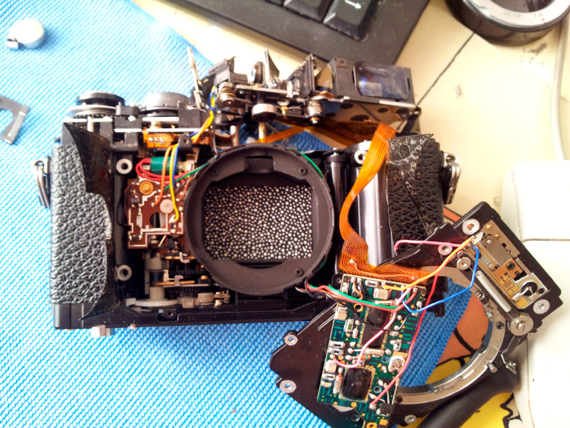

My recent purchase CLE ex Adorama just stopped cold. I knew it had shutter timing irregularities but figured that was just the dirty contacts issue. I sorted the wildly off infinity focus courtesy of my good friend Google. Then it stopped firing the shutter. Meters, battery tests but will not trigger shutter even with cable release. Have removed batteries, replaced with fresh.
A) Anything I can do?
B) Anyone left who repairs these?
I don't think 24 hours of ownership was enough!

PS Shutter and metering were fine as far as I can tell.

I've tried on various shutter speeds and auto. Timer won't start flashing. Its as if there's a broken wire from the shutter switch.

The problem you will run into if it needs a new circuit board which I suspect is the cause is they are no longer available. Most parts cameras have already been robbed of this board..

Unfortunately Bellamy would tell you that the CLE is unrepairable. I know, because a few months ago I was looking for a cheap M-mount camera with AE and I asked him about the CLE. He advised me to get a Bessa R2A instead. Even Kanto Camera cannot repair the CLE, and they can repair most things.
Edit: here's Bellamy's reply > "The CLE is unrepairable, basically a brick if it dies, and it will. The CL is repairable, but the prices are daft and many of them come with a dead meter. Much better off getting a Bessa."

Actually your both sort of right. Repairers are often just too scared to work on them. The response Jonmajiro got is typical of this. If the camera stops working it can be from a number of simple factors you cannot say its completely dead or unfixable without opening up and having a look. But its also true that it is a wives-tale XG parts can be used. The CLE is the only Minolta to meter of the film plane (They actually sold the patent rights to Olympus and they used it instead) and as such the metering cell and electronics are very different to any other Minolta Camera.
The CLE does sometimes have a simple wire break over time from the battery compartment. Also because of the unique battery cover that never comes off unless you break it, the contacts inside that cover never face outwards to be able to be cleaned. You can have corrosion all over them and you would never know. You actually need to remove the baseplate to access the contacts. This is one of the first places I would look. The first however, is the shutter fully cocked? Check the winder and also open the back to check the position of the curtains. Sometimes a film fragment gets cause in the shutter rails and brings everything to a stop. Only after checking this would i consider opening it up and it would be the baseplate not the top I would check under first. But remember once you undo one screw you have effectively voided any warranty or chance of return.
If there is something specific that you need from the manual I can see whats in mine but I am reluctant to copy any part of it sorry. Its written however not like a car workshop manual for home repairs is directly assumes you are a factory trained repairer and understand their specific methods and terminology so often when you read it you just go what the hell does that mean.

Ahhh. The sound of actual knowledge!
Just manipulated the curtain. It slid forward a further 1/4 inch and now all is well.
Wasn't that simple?
I guess there's corrosion or a film fragment but knowing it's just that is reassuring.

This one had a shutter curtain ribbon stucked. I had it all back in place and fired it once, then dead again. It's hard to work on the CLE and troubleshoot as you need power to get it running... Really great constructed with a module like concept but with lousy materials everywhere...
CLE Shutter problems

I have now had the botttom plate off the CLE which is a simple operation, one phillips screw and the retaining ring for the rewinder - watch out for the rewind button falling out and do not upset the battery check unit. Also, do not let the base plate dangle or it might separate some soldered power wires. I have pictures. The circuit board with the lens for the metering comes off with a few phillips screws - nothing very interesting or appearing delicate. Meter now working but no wind. Suspect something more than stuck curtain. Have moved it gingerly back and forth with no change - still no wind available. Pattern is visible on the curtain from the front. This camera was designed so it could be easily maintained. Beautiful finder. Will keep at it until it operates. Think something like stuck shutter magnets, like the Canon AE-1 has.
Found that moving an interior gear accessible though the bottom of the camera moved shutter just enough to get the whole operation working again. With bottom plate off, looking at base with front of camera facing me [winder side of camera to my right] just to the right side of the metering ciruit board is a black gear box plate with a gray colored lever in the left corner of the box. With a good magnifier and led light , looking into the camera void just under that gray "L" shaped lever, is a gear with what looks to be a counterweight arm on it that when moved just a little also moved the shutter mechanism so the camera could be fully advanced to cock the shutter and now trip the shutter release. Lubricated this and other gears sparingly and reassembled to complete repair. A long process from beginning because of lack of familiarity and trial and error process however success is sweet. Have adapter coming for Canon 28mm f2.8 to use on camera. Minolta/Leica piece of art this CLE.
