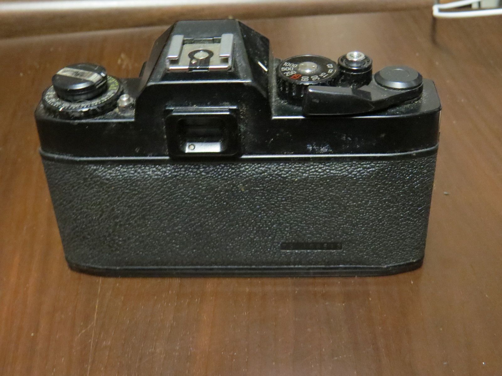

After reading through this thread I purchased an R with visible damage to the rear door coating otherwise the camera is in like new condition. I also ordered a Nikon FM10 door just in case. So I tried the above mentioned solutions starting with Armorall. Unfortunately this left the surface both sticky and greasy. The surface basically resembled the residue of deteriorated light seals and was now showing holes through the coating.
Since I had the FM10 door on order, I decided to clean it up with a rag soaked with denatured alcohol. This worked great. The door surface has a nice matte black finish. I noticed that the body of the camera was sticky so I cleaned it too. The alcohol removed the dull tacky coating leaving the surface plastic looking like new.
When I received the FM10 door, I found it to be no better than the Bessa's, so I cleaned off the surface on it too. It only takes a few minutes to make it look like new, however if your used to the feeling of the rubber coating, you may not like the feel of the plastic surface. I would have avoided all of this buy using a half case but then I would not be able to use the accessory hand grip.
So if anyone is looking for a lower priced Bessa, you might consider those with ugly door coatings that are otherwise in good condition.

Most of the discussion on this thread suggest removing the rubber coating with denatured alcohol. I was prepared to go that route, but was somewhat reluctant since the rubber had not really deteriorated to the extent that some people had experienced. The main problems was fading of the black colour and "sweating" through the rubber.
What I have done thus far. I began with vinyl conditioner (e.g. Armour All, for use on vinyl in your car). I first used a cloth soaked in very hot water to 'open' the surface of the rubber; I let the cloth sit there a minute and then poured the vinyl conditioner onto the surface, letting it sink in and dry overnight, removing the excess with a dry cloth. After a couple of these treatments, I switched to car polish. I vigorously rubbed the self-cleaning car wax onto the plastic, let it dry and rubbed it off. Repeat. The problem SEEMS to have been resolved - the coating looks much better and there is no more "sweating". Whether it will last over time and especially with warm weather around the corner, is of course another question.

Hey guys, I have the same problem that the back door became very sticky and I bought the methylated spirit in the supermarket (In Australia you can buy it from Coles or Woolworth). It works great and the camera just became like a new one!

Hi, traveler_101.
Yes, the plastic door feels a little bit more smooth than it was when coated with rubber. However, the feeling is not bad at all, since the plastic doesn't feel cheap. On the contrary, it gives you a solid feeling.
Of course, it depends personally, if your coat is still in a bearable condition, I won't recommend you doing this. However, if you are facing the same problem I had before (which was very sticky), then just remove the rubber!
