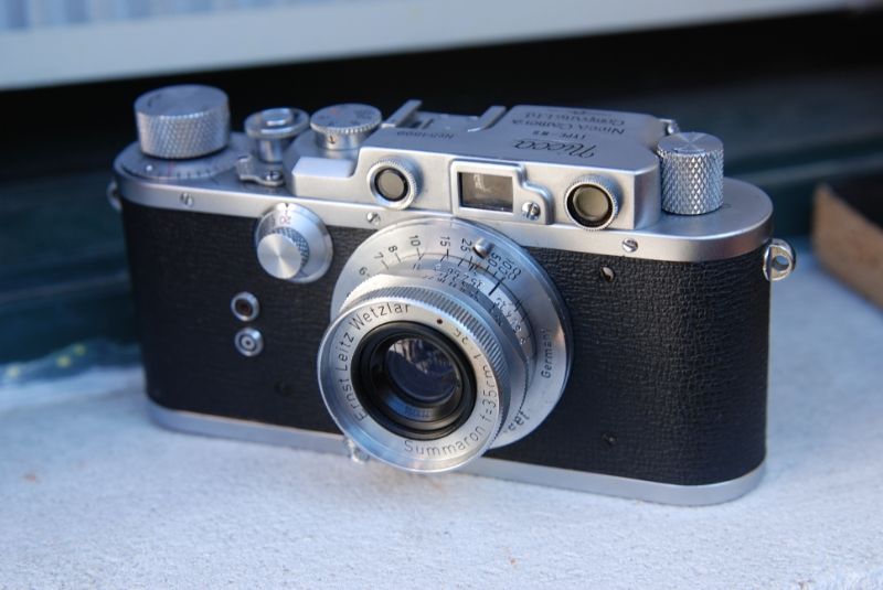

There she is with the Summaron. Super portable now. Small 35mm viewfinder is on is way.

Originally Posted by Lucadomi View Post
I did cut the film, but I will try without cutting next time. . . . .
I really wouldn't. Like an awful lot of short cuts, it works until it doesn't. When it doesn't, the perforations get chewed up and you get film chips in the camera. Rare? Yes. Unknown? No. It also slows loading.

I tried the Summaron today and i can see that at infinity the image is not aligning properly. I can still see the image slightly doubled in the rangefinder patch at infinity. I am not sure how is this affecting the focussinng but i think i will have to return this lens and look for another compact lens.

Before you blame the lens, does the camera RF line up at infinity with any other lenses? The wisest course is to send both the camera and the lens to someone such as Don Goldberg, to sort it out.
Also, do you know which flash socket is for which?
I have David Murphy's Leotax S. I believe the lower socket on my Leotax is actually for F bulb flash synch, as use of the socket with 1/20 shutter speed leaves a band on one side where the shutter curtains did not clear the film gate before the flash fired.
The upper synch port on mine seems to be an M bulb flash synch (fires 1/20 second before the shutter starts to travel). The flash seems to fire first before the shutter even opens, leaving the effect of no flash seen on the film.
I may send my camera off to Don just to get the F synch port converted to X synch for electronic flash.
