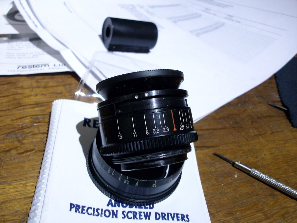

Hi folks, started de-assembling jupiter 12, under focus ring i saw these pairs of marks where the grub screws have been sitting. The ones to the right are where the focus ring lines up with the stops at 1m and infinity. I wonder what the marks to the left are from. Previous setting perhaps????[IMG][/IMG]
Old 02-03-2017   #24
Ko.Fe.
Me. Write ESL. Ko.
Ko.Fe.'s Avatar
Ko.Fe. is offline
Join Date: Jul 2013
Location: MiltON.ONtario
Age: 50
Posts: 4,244
Yes, it is from previous alignment for different camera. Usually you have to do it if shims were changed or heliciod was assembled differently. Shims and helicoid assembly are affecting focusing. Very.

Eureka!! I hope, forgive the erroneous terminology, but i noticed on dis-assembly that the aperture housing with the shims on, was not tight against the external housing. Hopefully, by default, i've cured the problem.
I might be stupid, but at least i'm not clever.
