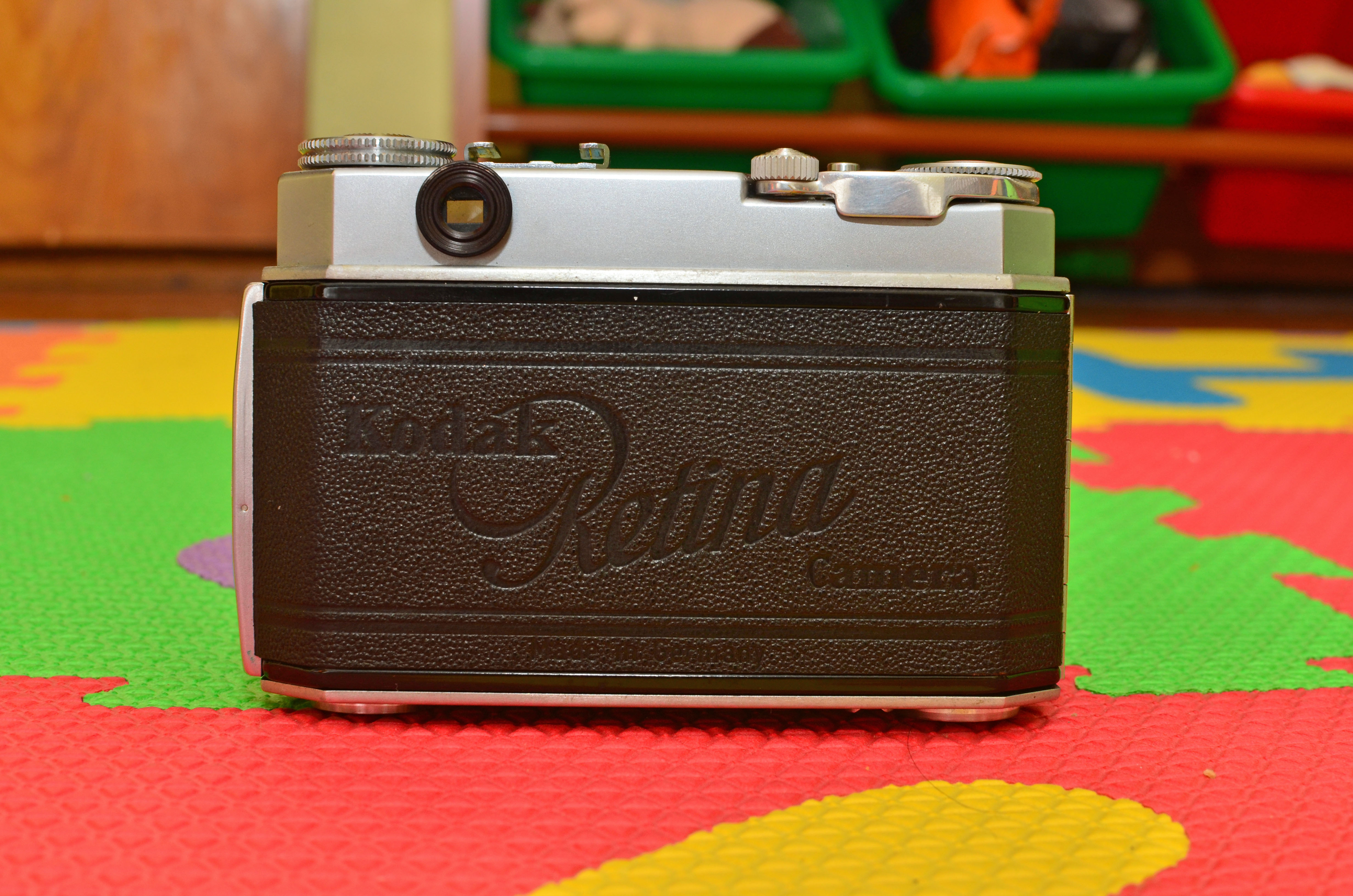

In case this helps, here are two pics of the camera. I didnt intend on taking them on the colored tile floor of my son's bedroom, but I was sitting there and liked how the colors looked, so I took this real quick just a few minutes ago.
Sorry to those of you with slow Internet connections. Its actually a lot more difficult for me to resize pictures first, rather than just sending them to Wordpress.
