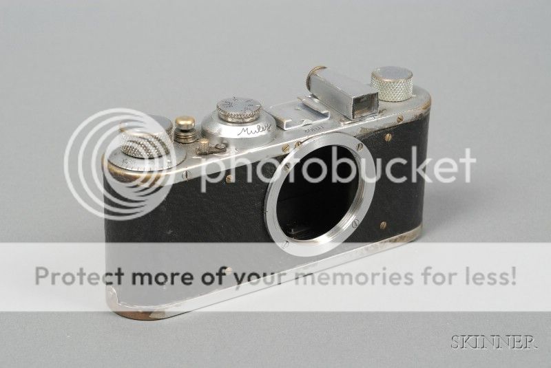

These guys should fake something that is really rare like this Japanese Muley Leica 1 copy from the late 1940s.
