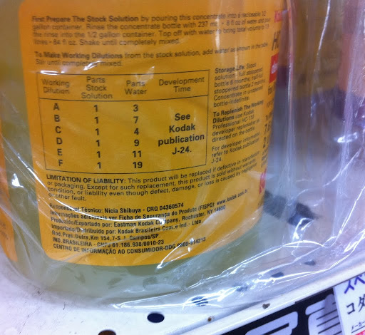

am i the only one who gets confused by hc-110 dilutions? My bottle says dilution B is 1:7 dilution. I've always been confused about this.
I think they mean working solution, already diluted.. We are working off the pure hc110 straight from the bottle...
I understand. The HC110 syrup I buy in Europe is much more concentrated than the syrup sold in Japan (US import I think).
Or is it the other way around?

The 'European version' of the syrup is weaker, and comes in smaller bottles (half litre?). It also works out rather more expensive to get to working solution. Fortunately, the 1 litre US bottles are readily available in Europe.
On solutions, there is the syrup, a stock solution, and a working solution. The idea is that one makes up stock solution in batches and then dilutes it further to working solution when about to use it. I'm not sure if the stock solution has a shorter lifespan than syrup. I presume the reason for making it is for easier measuring due to using larger quantities. However, I think most people find they get on fine with straight syrup and a syringe.
No, the syrup I buy in europe requires 79 parts water to make solution F
The one in Japan requires only 19 parts water.
